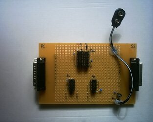

yano´s easy to build around 14€ with parts from wellknown "conrad" otherwhere maybe cheaper. most expensive was the testlayer with correct placements for sub-d-25-ports.
freewing complexer than yano´s and should be slowest one.
my yano-interface is with original AR unreliable (coz of my selected HCT chips, should HC) but with EMS 4in1 no problems.
I´m unhappy with speed over LPT with my yano/extands, even I programm maybe this weekend native extand-mode for sat.exe, because my benchmarks on psx show even K-comms caetla´s psexe.exe didn´t reach the speed of a pccomms only half of atleast what I got between PC-AMIGA. maybe it´s the "send and read it back behavior" of transfer to the saturn/psx which consumes 50% of the speed vs. pccomms. must have a look at the sources this weekend.
