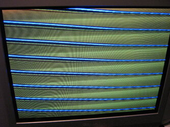

I've been doing the swap the same as the demonstration video I saw... I do it by ear mainly. I also tried the trick where you start the cdr, wait for it to stop, swap for original then reset and swap again... I just don't get it!
I attached a pic. When it feels like everything was perfect, this is the screen I get....
Originally posted by ExCyber@Mon, 2006-07-17 @ 04:48 AM
Do you at least get the "Produced by or under license from Sega Enterprises" screen before that?
[post=147091]Quoted post[/post]​
Yes

Have you tried this with different iso/games? It sounds like you may be succeeding with a bad backup.

I think you may be doing the second swap too late. Especially on the pickier Saturns, it's important that you pull the original out as soon as you can, i.e. as soon as the pickup starts moving back toward the center.

Yes I finally got it! I WAS doing the second swap too late. Contrary to what I read and saw in the video clip, the second swap has to be IMMEDIATE, not delayed 1/2 to 1/4 secomd. As soon as you hear it, the cdr has to be swapped in about a nanosecond. Not only that, but I have to give the cd a quick spin to give it a rolling start. Thanks guys. I wouldn't have figured this out without your advice.
