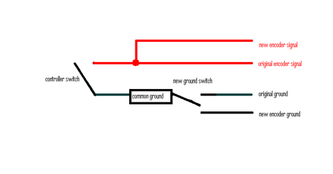

You could just wire all of the "ground" connections from each microswitch to a single point that could be then switched between the two encoders.
As far as I know breaking the original encoders signal path at ground would just be enough, but if it isn't you could cut power to it as well.
Here's an example of what I'm trying to say
(excuse the crappy Paint pic)
