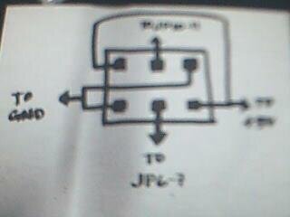

I couldn't see it, I dl but says drawing failed and is blank. :( Thank you for your help, could you try upping a new pic, in .jpg? Thanks again.
Ok here it is in jpg :) I hope it works
as you can see you need a 6 pin slide switch, connect the upper middle pin to the junction point 10-11, the lower middle pin to junction point 6-7, connect both lower left pin and upper right pin to ground then connect the upper left pin and lower right pin to +5v. check the connections before you proceed on testing the unit. Sorry if it is a litle blurred my cam is rubbish :D

Thank you very much! This is a great help :D I really appreciate it. I'll give it another shot. Thanks for taking the time to help me out.
