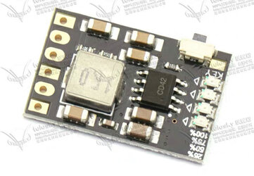

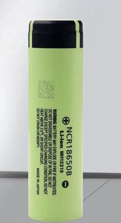

2CC41307-1F4F-4CBC-97A2-5D7159D15264.jpeg + BA42F0F0-57FB-44F4-9666-8974D41ABEDE.jpeg
1 18650(3400ma)battery run 80minutes

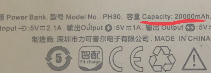

C2A7DBE2-D0C0-4699-B85E-37582F388360.jpeg E34E34C6-DD27-44B5-A08E-E54C9D4C035D.jpeg
Power bank (20000ma )run 8 hours
