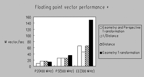

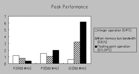

Those specs are shit. Remember how every apple is a supercomputer???? maybe toshiba use the same benchmarking program... Biasedmark 200X
Also they were only benchmarking floating point operations, a benchmark made specically for RISC processors. I even would go so far as to say that they have used specific machine commands for the EE.
The emotion engine was good, but it wasnt that good. Don't even start comparing RISC and CISC without showing ALL of the benchmarks.
The first graph is not even a benchmark at all, it is just a naive comparison of the major theoretical numbers. It completely ignores things like cache performance, random read latency, and the need to perform both processing and I/O. IOW these numbers mean next to nothing as an overall performance measure.
The second graph is, as you hint at, illustrating operations that are highly implementation-dependent, and which cannot be usefully evaluated without access to the code, compiler(s), and build scripts.
