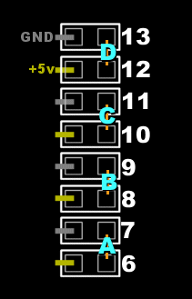

Ive followed the www.mmmonkey.co.uk guide but my switch seems to not work correctly.
Switch right gives NTSC-C, switch central gives NTSC-4, switch left gives NTSC-C also.
This is what my jumpers look like:
Where do i need to solder the wires to in order to get jap/usa/eur?
Thank you in advance.
Well ive now accidentally pulled the right jp 12 pad off. So have undone the mod by solder the right jp 13 pad to the left jp 12 pad. Works fine as a pal box again. I guess theres no solution for installing my region switch now?
Maybe i should buy a model 2, put my region switch on there and resell the unit for profit? Any ideas welcome! :(
