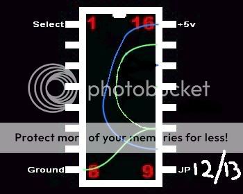

I'm having a bit of trouble understanding this mod, mainly how the switch is done. I know the 'select' line must be changed from high to low or vice versa, but how is this done? Is there a point on the reset switch that changes from low to high after the Saturn is reset?
Also, cant this mod only switch between two regions? as there are only two outputs?
Any help would be really appreciated :)
See what happens is this.
When you push the button to open the CD tray or Reset button during the press a connection is completed allowing 5v through.
The ground and 5v is connected to the chip, and when the circuit is completed 5v is sent to the select pin. When this occurs the chips logic swaps the output of the xY (where x is a numeral) between either inputs of xA and xB. Basically meaning that every time you hit the reset button it changes JP6/7 between ground and 5v. (witch is why there are the wires on the chip, sending ground and 5v to all the xA's and xB's needed).

So, does the a change in the select line from ground to +5v then back to ground (because you let go of the reset button) tell the IC to from now on take input from xB instead of xA?

Well I know a guaranteed way it would work with two of those ICs and I don't have to test anything to know that it works.
The thing is I believe I could wire something together to make it work with just one IC, or get the 50/60 using 2 ICs... probably 3 ICs to get 50/60; or a different model one. I just need to test the inside of the saturn to see how the buttons react and plan a more economic switch.
anyways, this should work though using 2 ICs:
Wire the first IC like gamesx.com says to and connect it to the reset button.
Then wire another IC like this hooking the labeled pin to JP12/13 like you did the others. Then connect it to the CD tray open switch to 'select'. (pins located on underside of the saturn in back where that plastic doohicky open switch is... you should know, your rather educated)
Now for modes what you will do depending on what it boots into when you turn it on and dont hit anything.
If it first boots as US (I believe it is this one)
Jap - reset
Euro - CD cover button
If it boots Jap without hitting anything then.
US - Reset
Euro - CD cover button AND reset

You only need 1 IC. I created the 3 region switchless circuit based off that info back in 2003 or so. In fact, i modded someone's system here with the prototype of the Switchless 3.
