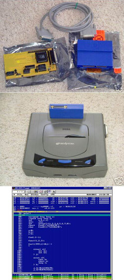

This auction is for a Sega Saturn PSY-Q Development System.
SN System�s Psy-Q for the Sega Saturn was the fastest PC based cross development system for producing and testing mixed C and/or assembler programs for the Sega Saturn console. I�ve personally used a Psy-Q system for developing various titles for the Sega Saturn including Mortal Kombat Trilogy. It is a complete development solution for the Saturn programmer... or these days, Saturn programming hobbyist. It originally cost about $5,000 new.
Auction includes:
  • High performance Psy-Q SCSI interface card for host PC (16-bit ISA card). Sorry, but you can�t use a fancy SCSI controller with this card. PsyBios (the TSR that talks to the adapter cartridge) will to talk to this card only. Because of this, the system requires a PC with at least one free 16-bit ISA slot.
  • Compact Saturn adapter cartridge, including extensive firmware stored in battery-backed SRAM
  • Japanese Sega Saturn with Psy-Q modification board. I�m not quite sure anymore what the modification board did - it either added a NMI line for the debugger to catch crashes or allowed for additional CD emulation... or both. I�m including an original CD of Sega�s Virtua Fighter (Japanese version). This is needed to boot the Saturn. Technical mumbo-jumbo aside, it works in lieu of a Saturn key disk. Power supply cable and video cable are included. You�ll need your own controllers.
  • A CD of Psy-Q software. I do not have the original installation disks. The CD should contain everything you need to get going - let me know if it doesn't. The SGL and SBL can be easily obtained online. I�ll give you the URL.
  • 300+ page manual

The system appears to work. I powered up the Saturn and plugged the cartridge in. My TV displayed a nice "PSY-Q" screen. I can't verify functionality, as my system does not have any 16-bit ISA slots. However, the card (and adapter cart) has had a happy home in a nice anti-static bag for the past 6 years, so everything should be good.
