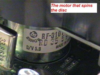

I open the system up. Power on. Same thing happens. I test the disc lid senser switch. Upon pressing it, the laser lens moves south and then nothing happens. It does not spin a disc. It does not shine a red laser. It does not pump up closer to a disc to attempt to read one (to see if there is one).
