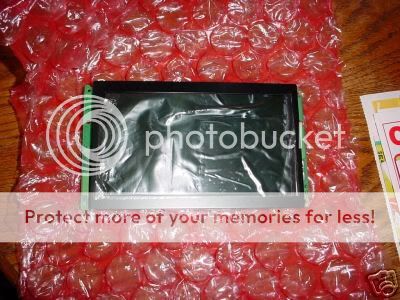

OK...
I got a 8 inch wide screen LCD with controller card for a car DVD player for 10 USD. Its actually pulled out of one of THESE!!!
Like I said its just the LCD
My question is I need to figure out what the pinout is for the video and power on it. I can't find any info. There are 3 spots on the back.
one plug has 13 pins and they seem to all go to these 2 rows of silver drum looking things that say "33 VFC OC4" on them.
then the middle plug has 14 pins and seems to go through a large circuit and then off into the LCD through the LCD digital cable.
the 3rd has only has 9 pins and goes through the circuit like the middle one does. it also looks like it crosses over with the middle one. Im thinking it is possibly for a video in for an extra parapheral. The item description says it has video in to hook up extra things to it.

Heres some pics of the LCD controller on the back. (it comes off of the LCD screen easily)
they are REALLY high res, so you can see detail.
clicky to make me grow
sorry a little blurry
Let's talk chips. Can you identify any that the inputs go into? Particularly interesting would be anything from Silicon Image (part number starting with "SiI") or Analog Devices (part number starting with "AD"), though the components I'm interested in could be other manufacturers too.
Those are all the chips on the side i believe to be the video stuff. Im not positive though. If you want info on the other side I will gladly list them.
