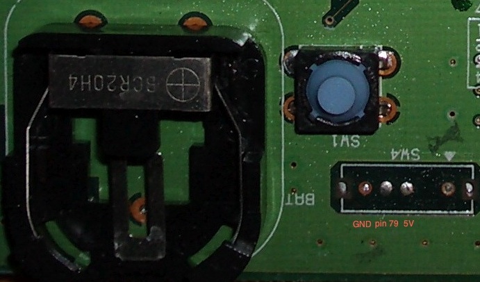

I was probing around on a Saturn board (as you do on Thursday evenings) when I noticed a place for a switch near the rear, next to the battery slot. After a bit of tracing, it turns out the middle pole is connected to pin 79 of VDP2 which is the pin you use to switch between 50/60 Hz!
Can someone else confirm this? If I'm correct it's a bit odd that it's gone unnoticed for so long and that we've been cutting traces, lifting pins or other acts of violence instead.
(edit: Not surprisingly someone else discovered this earlier.)
