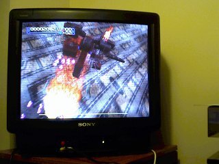

Hi Mia Bocca 🙂
Sorry to hear you no longer have the Sega Saturn unit.
I can help you out.
I also live in the UK and use a Sony tv for full screen gaming.
Also on different machine models and formats.
I can be contacted via email if you wish.
Kind regards,
Ian. 😉
