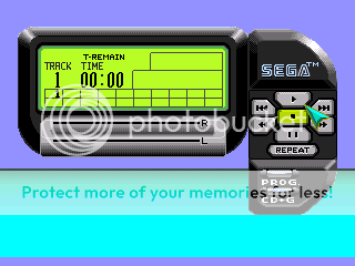

Yes when I turn on the genesis without a cartrige the acces led on the SEGA CD blinks and it shows the BIOS screen:
if I press the star button it takes me to this screen:
