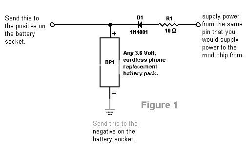

Perfect, exactly what I was looking for. This guy has already done it with his freaking Comp... DOY! He did it exactly how I was thinking too (minus the diode and resistor, hrmm, its a good thing i googled) I'll just use the 5v off the saturn PSU board and make this bisnatch and let you know how it works!

rechargeable 3.6V portable phone battery - 6 bucks (or free if you are like me with about 20 lieing around)
diode - 1 dollar
1/4W resistor - 1 dollar

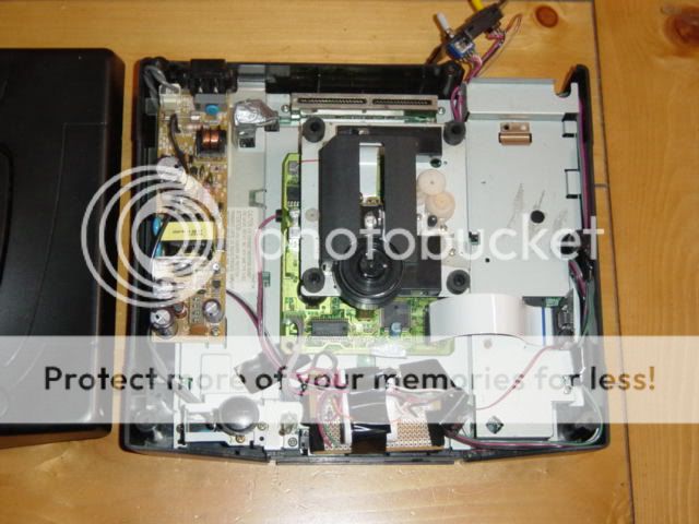

here is how everything installed looks. And yes it can be done with the VCD card installed. This image here is a model 2 US saturn with a VCD card, mod chip, country switch and battery mod.
This pic though is of my saturn I sold to someone in Great Britain... the one I have at my house right now is a model 1 and it also has a battery mod and a chip in it and it works great! no pics... sorry.
towards the front of the saturn to the right of the power button... you see the bread board with the white battery held on with electrical tape? thats it. I combined everything into the bread board though. That is also where the hex inverter is for my country mod and also I disperse the power for everything through that board.
Here it is sketched out from that website and I listed where each wire should go.
