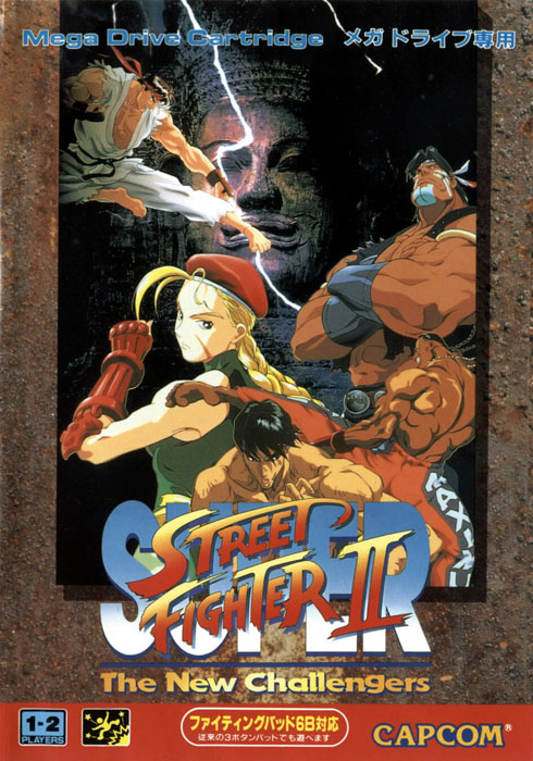

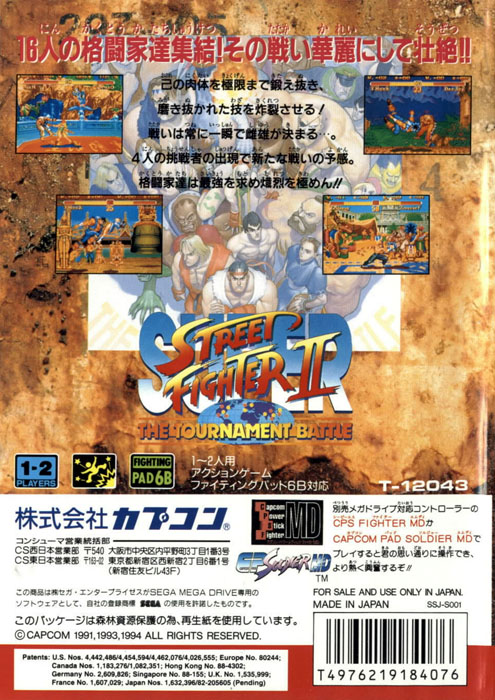

Hello.
I recently bought Super Street Fighter II JAPAN region, brand new for the SEGA Mega Drive (Genesis).
I have a EURO-PAL SEGA Mega Drive & a Universal Adaptor to play import games.
The game starts up fine but when you get into a match, the character & level graphics are really messed up making it unplayable.
This is surprising as the game was brand new-boxed & doesn’t look defective in any way.
Is this some kind of region-lockout protection CAPCOM has installed into this cart to eliminate the universal adaptor, or is this simply a defective cart?
I’m aware that some protected Mega Drive games did exist in the past, but I’m not sure if this was one of them?
All my other imports work fine…
So do you guys think this cart is defective & should send it back to the shop & get a different game or is it just a CAPCOM region protection?
Thanks in advance.
