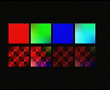

Saturn video output (captured at 352x288, hence the extra black borders):

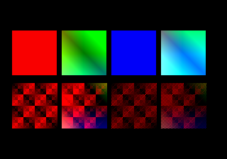

Yabause screen dump:
In your screencaps, it looks like the Gouraud-shaded rectangles are split into four sub-rectangles. Is is an artifact of your capture device or is it some VDP1 internal implementation detail showing through?
The one from the Saturn or from Yabause?
I think the shading looks better (smoother) on a real Saturn, but I don't know if it's due to some difference in interpolation resolution, or just because it's an analog signal coming through a composite cable whereas the Yabause output is purely digital.
I hooked up the Saturn to my TV and it looked the same. So whatever is happening with the shading isn't due to my capture device.
