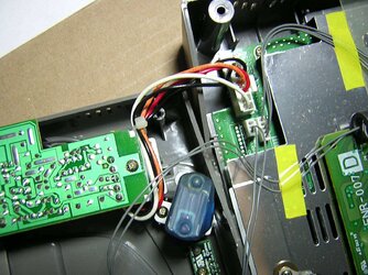

There's no need to hack you either use the 21 pin slot or the 20 pin, the modding seems the easiest of them all I haven't tried it yet cause I don't have a multimeter yet so I don't know where exactly to get the +5v.

If you have a model 1, check my guide for 5v. In general red should be 5v ;)
About the hacking, in order to use a 21 pin mod on a 20 pin box, you need to rewire it and remove a section. The mod above seems to be an alternative solution, one id like to hear proof of working before i buy ;)
It seems a bit different from yours you saying the red cable is normally the +5v? Thanks at least I have a starting point I'll check it out later.
[post=138678]Quoted post[/post]​
From your picture it looks identical to mine.
Take the power supply away from the lid (two screws by power lead socket and one on top of board iirc) then look on the board, it should have the wires labeled on the other side. :)
