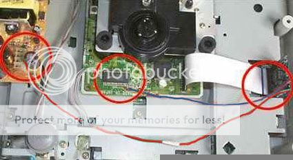

thanks for your answer. i will check if everything is alright with the ribbon cable. is it also possible that the power wire is not on the right pin. i have a pal model 2 and according to the some pictures, who were posted here, it must be 32 pin too. but i have 5 pins and not 4 like it is shown in most of the pictures. which one is the 5V one? if i look at the mainboard it says "+5V 3A" but next to the third pin in the middle.
btw i did the a+b thing with some wire. maybe my soldering is not the best and i should do the bridge like i did for the 0019 thing?
my board looks like this one
the only difference is that i have 5 power-pins

the instructions from racketboy say "plug it into the second pin from the top (back of the unit) even if you see 5 pins instead of 4" and if that does not work then i should try the other one. i guess bad luck for me.
