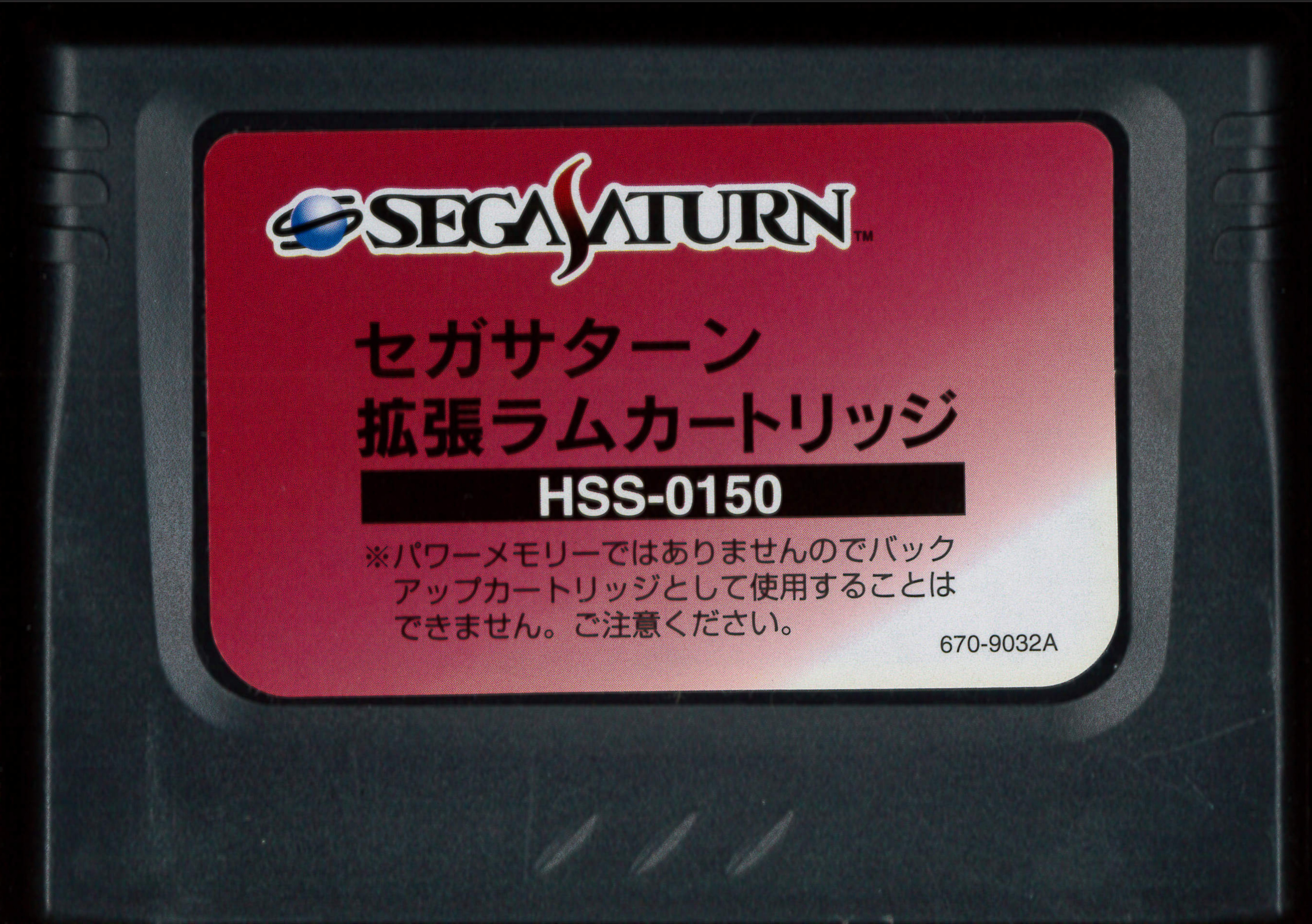

Here are the pcb images for the sega saturn ram cartridges.
1Mb Cartridge (2x HM514260CJ-7):
Front
4Mb Cartridge (2x HY5118164BJC-60):
Front
With some search, i did find some sellers for this memory chips, but the controller chip can be replaced for making replacements for each cartridge?
