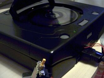

I have included some pics,the switch is from the first trial run after hacking the small grey wire loom at the bottom left of the pcb(THIS IS NOW NOT NECCESARY).
Hope this helps you out.

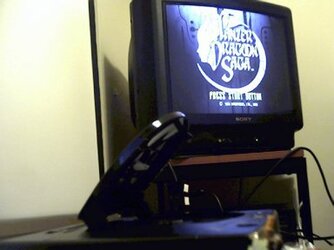

And the game in action.
Spin,Spin,Spin. :thumbs-up:
P.S. You can still close the lid,It will not stop the the game etc.
If there si no disk in the machine it will stop trying and wait.
