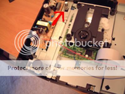

well its a crappy pic... but you see that thing my arrow is pointing at? its a switch, tape it down!

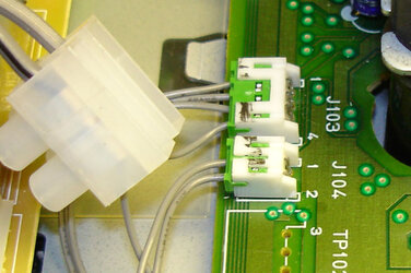

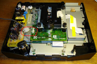

It's been a while since I visited this great site. A year ago I posted some info about an easy mod that makes disk-swapping a lot easier and less destructive. But I notice that it hasn't gotten the attention that it deseves.
I have now taken a couple of better images and made a small video to show how great this mod works.
[attachmentid=1289]
[attachmentid=1290]
[attachmentid=1293]
And you don't have to worry about killing the motor for the lens... or anything else for that matter. Because the power is cut while you do the swap. I have used this mod for a little more than a year and it works perfectly every single time...
The original post can be found here:
http://forums.segaxtreme.net/showthread.php?t=9740
As you can see in the video, the switch I use is just taped on top of my Saturn... I don't want to drill a hole... But ofcourse you can make the switch look much nicer than that.
Hm.. maybe I should mention that my Saturn is a Model 1 with modelnr:MK-80200-50.
Ofcourse I do not take responsibility for any harm that you may cause to your Saturn if you try this.... But it sure is worth a try..
I had some problems attaching the video... I had to rename it.. If it doesn't work try to save it and rename it to "swap.avi"... its coded with ffdshow xvid...
