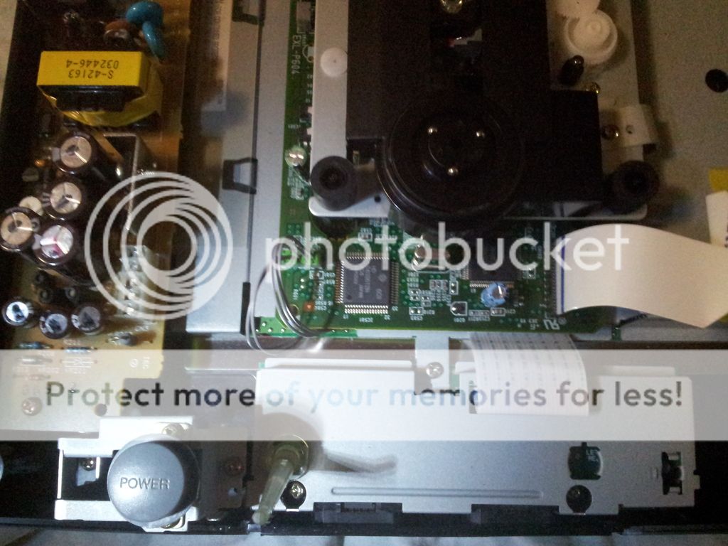

Yep, that worked well! ok, now what? Is there one more step in the procedure that may have been missed?
So, i de-solder the mod board now that it is not needed? How else will i know if this newly flashed ARC really works or not?
Pretty much that's it. You should be able to play burned games now and play games for any region.
JDE, you looking to maybe get rid of that Saturn modchip by any chance? That's assuming that everything went well with pseudo saturn for you. I might be willing to pay you for the chip if it works and is in decent shape (works etc). If you're interested, send me a PM.
Ah, i see now fellas! Didn't need to de-solder the mod board to test it, i just put the flashed ARC into one of the other five or six unmodded Saturns i own to check it out.
