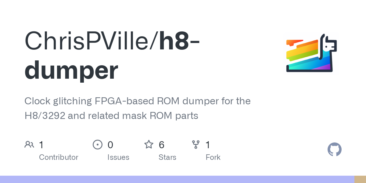

I have another crusade to you. I see at this moment that there is a method to dump H8 microcontroller ROM. Maybe it could work on first versions of CD Drive that has a H8. This is a glitch method using FPGA.Try to find a way, or some exploitable way.
I didnt know that, if have know before I dont have buy the CDB daughterboard, and didnt embarked that crusade.
Even so, I will follow researching.
Excellent. I've downloaded now. Thank you.There are three versions available in the MAME romsets (satcdb.zip).
This guy is dumping the servo controller of N64DD.
GitHub - ChrisPVille/h8-dumper: Clock glitching FPGA-based ROM dumper for the H8/3292 and related mask ROM parts
Clock glitching FPGA-based ROM dumper for the H8/3292 and related mask ROM parts - GitHub - ChrisPVille/h8-dumper: Clock glitching FPGA-based ROM dumper for the H8/3292 and related mask ROM partsgithub.com
