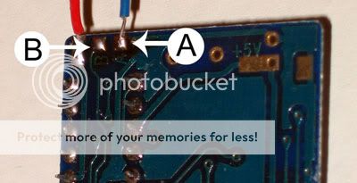

You see the blue wire? It is connected to solder pad A... all you do is solder the other end to solder pad B. Then the red cable you can tape or solder to the 5v on the power board. And of course plug it into the mainboard where it goes (you can see full directions elsewhere... but that is specifics on the amount of soldering you'd have to do).
