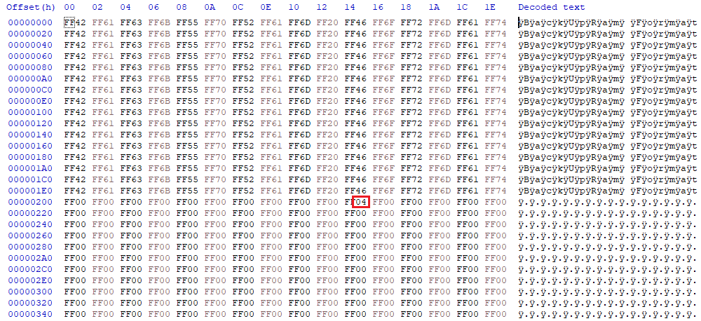

There's one suspicious byte in the blank block : is it that which is preventing from using a standard memory cartridge ?
From the fact that save record size is slightly larger than Saturn internal memory, I suspected some kind of artificial limitation to require a cartridge to work. And from this stupid limitation, we are now sure that it was an intentional design of this game in order to force the sale of backup memory cartridges colored in pink.

Thank you for the analysis @stevekwok !

My previous analysis was based on false information and completely wrong. Please don't be misled by that. There is no authentication block or magic bytes. I'm very sorry for the misleading information.
I overlooked @fafling 's post ( [Saturn] Tamagotchi Park - save game restore/dump? ) which confirms that importing the save in BUP format makes the game working, so authentication block seems not to exist. Anyway, because this save is just ~3% larger than Saturn internal backup memory and that it can't create an empty save by itself, I still consider this game as a scam 😀
BTW, the non-zero byte in my previous post is set in other dumps of regular backup memory cartridge, so it's probably some kind of debug information or leftover set by Saturn BIOS.
