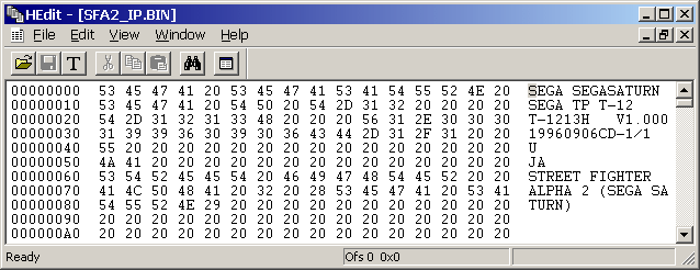

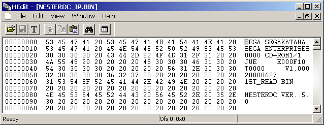

I believe TakaIsSilly is right. In my little , I realized that the Saturn boots from the first file in alpha-numberic order. Compare these two IP's and see for yourself:
NesterDC IP.BIN
SFA2 IP.BIN (Saturn)
NesterDC's IP specifies 1ST_READ.BIN, but SFA2's IP doesn't seem to specify what file to boot from, so it's pretty logical that Saturn games boot from the first file by alpha-numeric order as ExCyber pointed out in my little <a href="http://www.litespeedcomputers.com/sx/forums/index.php?act=ST&f=5&t=4092">SFA2 experiment

It boots the first file in the root directory, which due to the way the CD build tools work often is the first in alphabetic order. But it doesn't have to be. The Saturn's IP is fully documented and there is no place to specify a filename. I believe you can instruct the BIOS to not load any file which can be desirable if your AIP (application initial program) contains a filesystem driver or something similar. This will also minimise the time the SEGA logo is displayed when booting.
